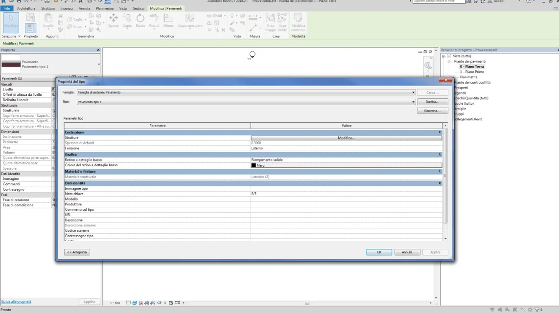

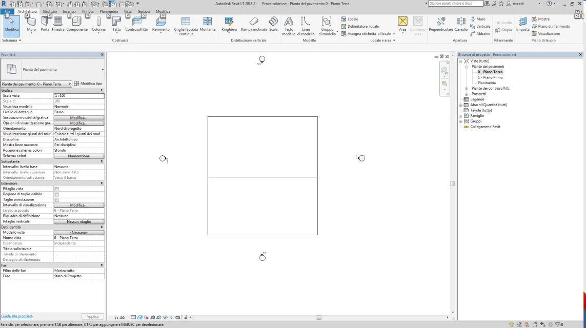

hi, to differentiate different types of flooring in a project, as I did for the masonry, I would like to indicate in the table different nets with the setting graphics - small detail net.
I tried in different ways by moving the display range but I can't set the nets; remains all white background.
an option would be to attribute the retini to the materials but it does not make sense then to see the retini also in 3d.
Do you have an idea? Thank you.
I tried on a new file but it makes me feel the same problem.
I am using rvt lt 2018.2.
I'll attach two screens to see if there's any mistake, thank you.1.webp2.webp
The error is that you don't know how that parameter works.
the small detail net is relative to the sectioned element, not in sight
Okay now I'm clear. to differentiate the walls in the table I can well because they are dissected.
the problem is with countertops and floors; for the moment I did some samplings but I did not like it because in case of changes I still have to rename them again and not miss in the computation in the abachi.
thanks anyway for the answer
