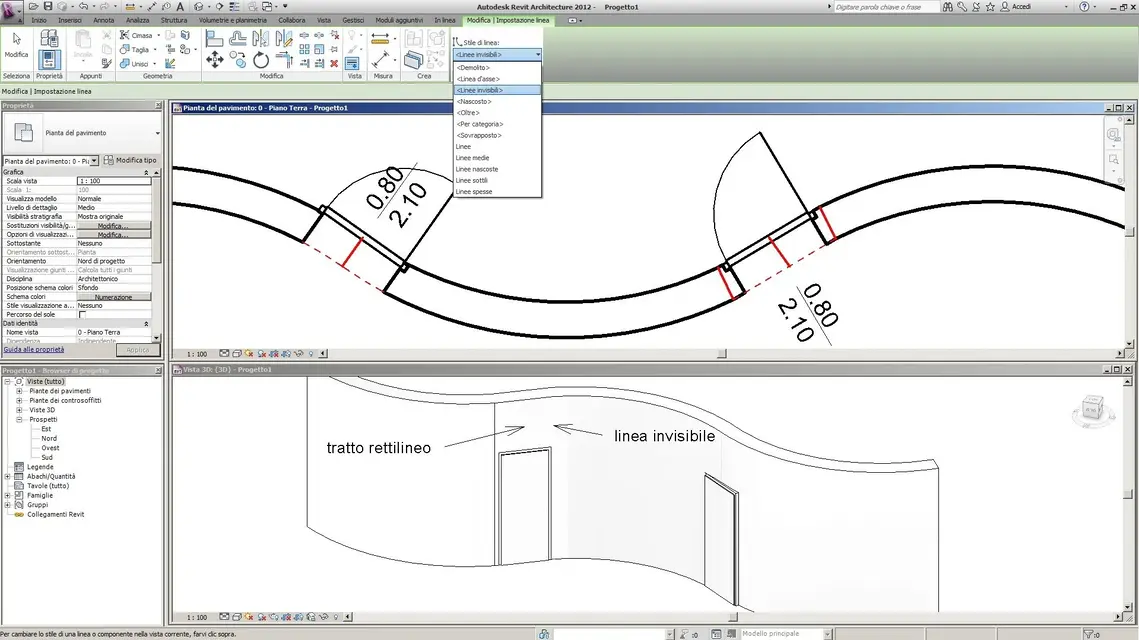

I find myself in the situation of having to put a door in the joint of two curved walls (to understand at the point of flexion of a "s"). the problem is that revit associates the door to one or the other wall.
How do I solve this? is it not possible to join the walls?
Thank you!
I tried with revit 2012 and gives the same problem, I tried to build the wall as a solid extrusion but idem.
the solution as you can see from the image is to cut the two walls and build a minimum straight tract between the two, the door fits exactly,
or if you want to have the wall above the door however curved by forcing the wall with a solid of subtraction as high as the door, always stick the straight wall as high as the door and then insert the door.
They're gonna see the joint lines of the walls, you can make them invisible, I did it with a demonstration.
(red lines are only additional indication lines)
