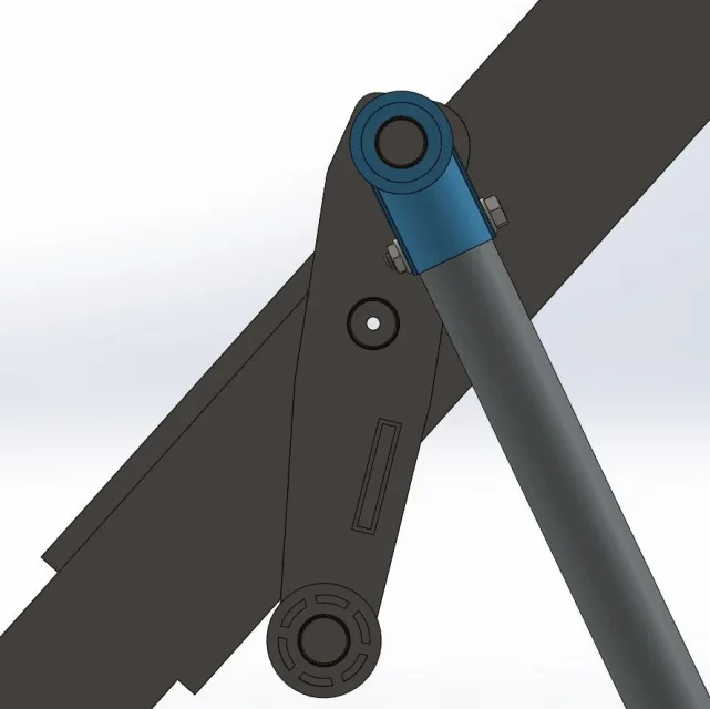

for the examination of construction of machines I am carrying out a project of a double scissors lift from workshop for cars, but I met some hitch. First of all, I found that the most critical point for the piston is when the lift is practically closed, and right at this point I get forces that are more than 100 kn (about 11 tons) considering that I have to lift a mass of 1500 kg. with this force, however, the pin to which the piston is connected is really too large. So I was wondering if the order of magnitude of the piston force was consistent with this type of application or I made some mistake in the equation system from which this force turns out.
I also attach photos of the lifter and how I scehmatized everything.
Thank you in advance!

If the angle is small, the lever is unfavorable....then the force rises a lot.
They have already responded with a variety of discussions to get very useful information. .
If you start from a very unfavorable angle (highly aligned rotation centers), the force grows very much, up to the limit case of the cylinder aligned to the fulcrum of the system, which is a singularity and does not allow the cylinder to start the whole.. .. maybe you just have to start from a slightly different angle, to have much more reasonable pushes, even of an order of magnitude lower at times, at the price of a few centimeters lost
Thank you all for the answer, excuse me for the delay. I will try to move the point where the piston is hinged so that the angle that creates the latter is as large as possible.
