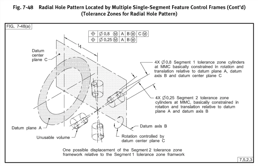

I always recommend taking (admitted to chew some English) asme y14.5
1575562607177.webpanother type of example:
