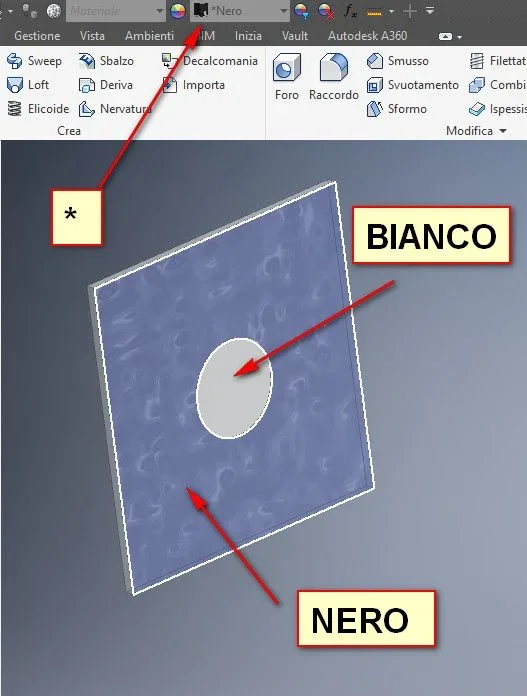

I am damaging to make polycarbonate dowels thickness 2 mm 60x60 mm with a back silkscreen compared to the side in sight or pressure.
attributing to the ipt the transparent polycarbonate material works everything, but when I go to draw silkscreen in 2 colors, with 2 independent sketches and extrusions I can not give a nice full color.
What does that asterisk mean next to the black color?
Do I have to set up some properties?
2017-01-28_123845.webpgrazie.

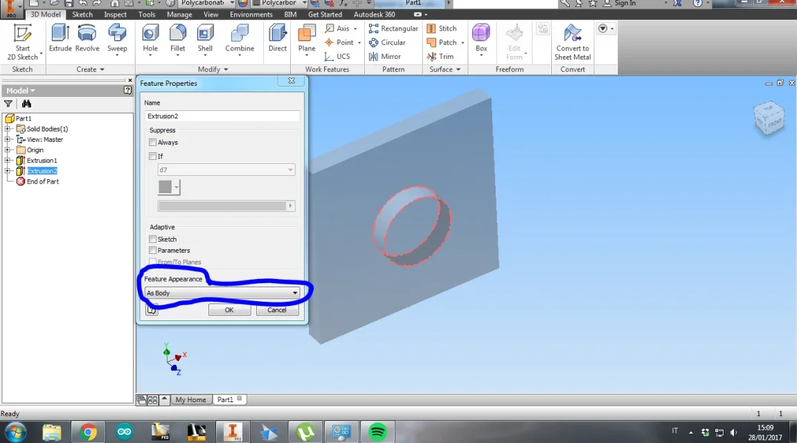

try to see if you get the desired result by making changes to extrusion properties
if it is only a cosmetic thing I use divides (under modification) instead of extrusions and change the color of the divided parts
