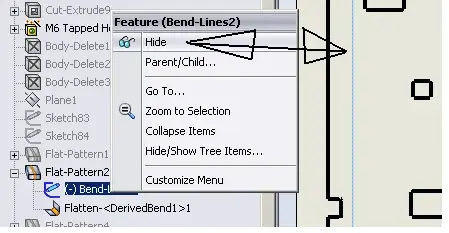

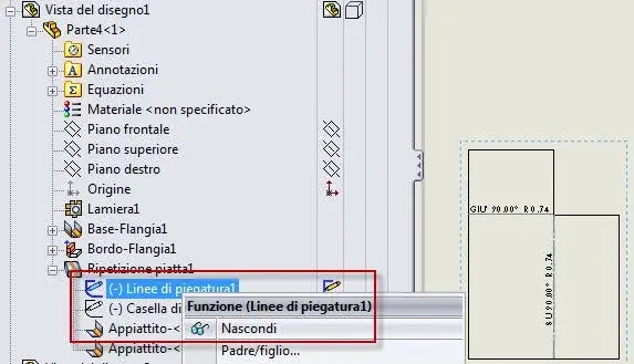

I tried to put a sheet metal on the table by choosing the "flat pattern". The problem is, it shows me the words "foot up" or "foot down" but instead I don't see the lines bend. I tried to export to dxf, but I'm not even there, so I exclude a graphics card problem, which is still a fx770m picture.
in the model 3d developed instead the lines I see them.
I'm definitely losing myself in a glass of water but I can't find the option to view these lines.
if you use sw 2011 less than sp3.0 there are problems... We have already discussed this. could be a kiss... seen that you know it should work in theory
I have 'hidden', you will have 'show'.
p.s: sincerely I have not heard or known of such a bug.
It's more likely that you have 'split' on the file.
If I suffer on the icon as you did the line appears, but then it disappears as soon as they flood me with the mouse.
