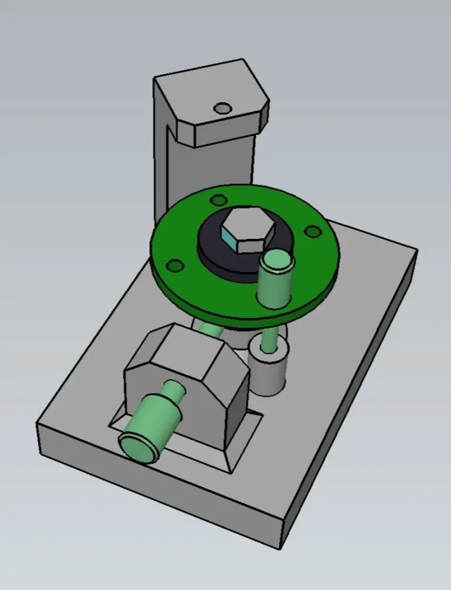

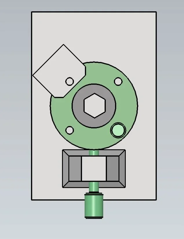

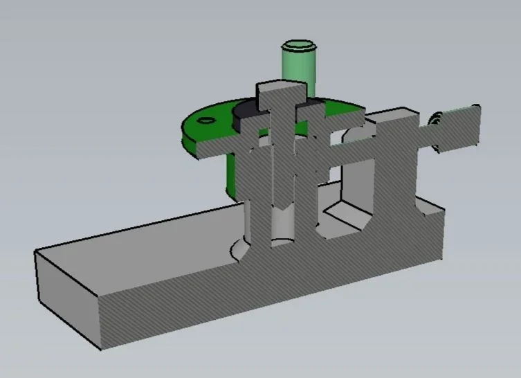

I also have the equipment made in 20 minutes on the flight with freecad 0.18 and mounted with the workbench a2+.Screenshot_20210105_211511.webpmodeled a bit of racing, you could however optimize a little in height and a little for welded blocks.
as you can see the two centring pins and the drilling axle are not aligned.Screenshot_20210105_211358.webpMoreover you can replace the fixing m10x50 screw with a destako that quickly blocks the flange.Screenshot_20210105_211730.webpSo, how are you doing your equipment?
I also have the equipment made in 20 minutes on the flight with freecad 0.18 and mounted with the workbench a2+.View attachment 60555modeled a bit of racing, you could however optimize a little in height and a little for welded blocks.
as you can see the two centring pins and the drilling axle are not aligned.View attachment 60556Moreover you can replace the fixing m10x50 screw with a destako that quickly blocks the flange.View attachment 60557So, how are you doing your equipment?
