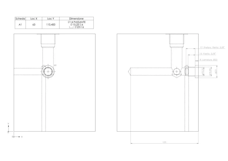

I detected a problem while creating table holes of solidworks
that represented is a manifold block with a main hole on which converge other satellite holes for utilities
made the model with sw2017 sp.5 but I made it try to a friend with sw2018 sp.4 and sw2014 sp.5 with always the same result
on a face there is a combined hole consisting of:
- blind hole for fluid passage ø14 depth 125
- deep ø23 blade 6mm
- 3/8" hole at the base of the lamatura with useful thread 13 preforo 17 (quote modified by the default)
on the other faces there are other combined and smooth holes that go to intercept the hole indicated above (I do not put the other measures as it does not serve)
as seen in the picture, in the table the caption is automatically added on the hole ø14 "passante" while passing is not at all (prof. 125)
also the threaded hole caption is not accurate as it does not indicate the thread type (3/8") and however the depth is incorrect
in previous versions if not erro you could overwrite the text box and do manual corrections, while now it's all blocked and can't fix anything
the speech changes if I suspect satellite holes: seems as if sw really follows the flow of the fluid and so if it finds an opening the label "passing"
I tried and tried to change the parameters, thread etc. but I don't get out of it
Have you ever seen anything like that?
as always thanks for feedback

to me shows the same problem as you. is the 20,00 mm hole that creates the ''problem' . If you suppress the table marks the depth of 125,00.
if with the hole insert a depth of 80,00 (in order to exceed the hole from 14,00) the table shows the depth of 125,00 . If in the hole from 20,00 put the depth of 69.9 the hole from 14,00 becomes passing.

by doing some tests it seems to me that the problem lies in the hole ø20.0 (20)-1 that does not completely cross the hole ø14.0 (14)-2 and this for some reason sends the table malora.
in fact bringing the depth to 76.6 (lower distance of the hole from 14) the table comes out correct, bringing it to 76.59 the table comes out wrong.
