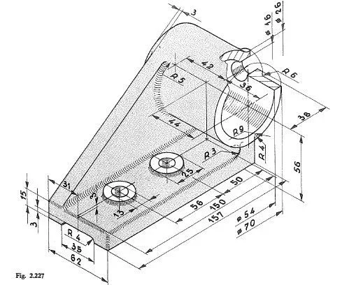

hello to everyone, I ask something maybe stupid but I have a doubt.
the highlighted quota of 30 to what it refers?
sec me represents the depth of the semi circular part but 30 is exaggerated, perhaps it is 3.
What do you think?

It's the wrong amount of the exercise. It is clear that it is 3 mm and not 30 making the proportions with the depth in the same direction of 8 mm.

I'll find an old post for a doubt more than anything.
the length of the cylinder diameter 70 mm is: 36+42 = 78 mm.
Is that right?
thanks to all in any case.
