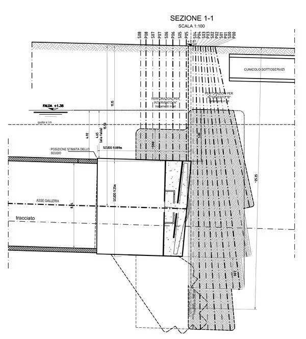

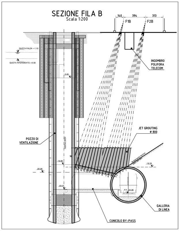

the limit from which you cannot escape is the interconnection of the columns at the bottom hole.
if you plant the column mesh at the bottom hole that you connect, the starting point of the drilling can have only 2 possible provisions:
a) perfectly vertical - this implies that if the column at the bottom crosses, it intersects at any other depth.
b) perforations with a focus - this implies that if at the bottom of the hole they are interconnected, they will be even more at less depth.
therefore you can have "certainty", simply by making sections along the files (1 for each different row), and also have the relative lengths, and also check for any unnecessary treatment cumshots that can be deleted not by fitting the valves in that section.
It's 3d thing I see an absurdly Moroccan complication. . .
I attach you 3 images of what I say, a simple treatment,1.webp2.webp3.webpThen I'll give you 2 more of a complex treatment. . .5.webp4.webpno derived from a 3d
