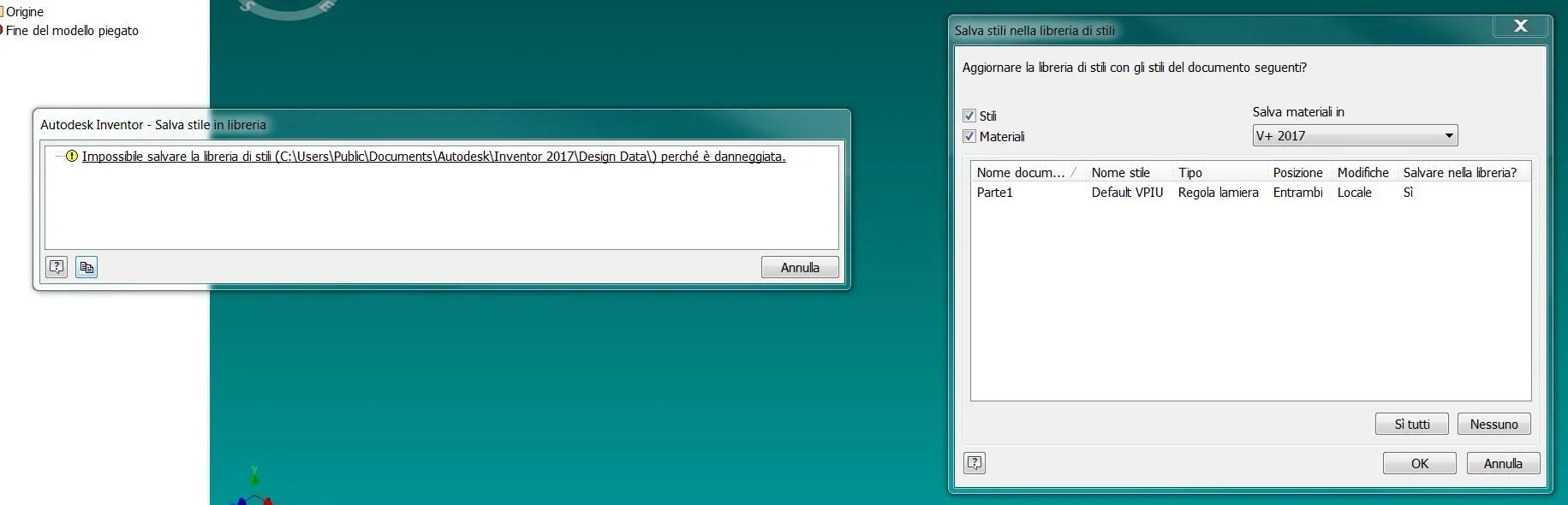

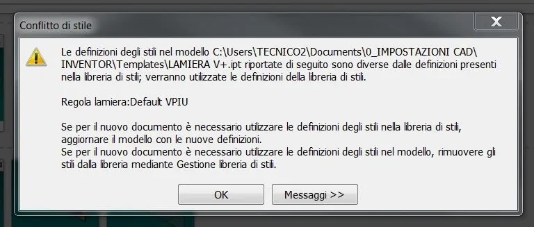

Good morning, I don't give it out with saving and customizing the material library. I list all the errors that give me by attaching screenshots.
premise: Autodesk inventor 2017 perfectly fired and updated.
new?lamiera?create?1 error
I do ok to continue and I get the 2nd mistake
I do ok to continue. at this point I go to change the material in "default sheet values"> sheet rule >material here I find a material "generic" and not "aisi 304 2b" that I created!
. Then I change it by giving it the right one. I go to update the library so that I no longer ask these changes and error windows on management>style and norm>si all>ok and I get the 4th error
We're in charge. unless the model changes anything. if I create a new file repeats all the string of errors.
Help!
.We're in charge. unless the model changes anything. if I create a new file repeats all the string of errors.
Help!
