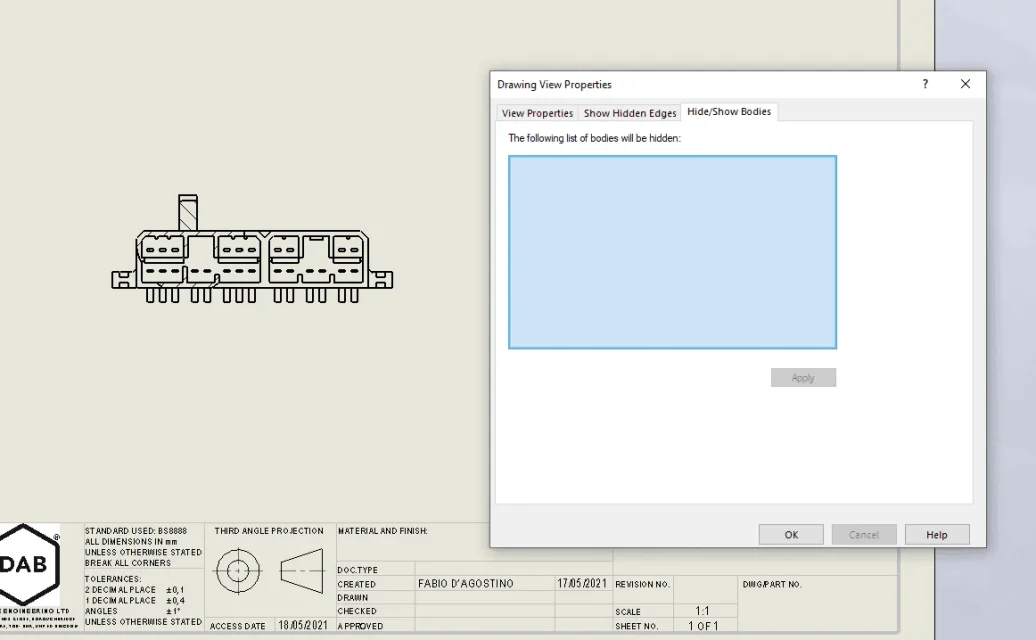

that you know, you can exclude a body from the decomposed section at the table
to clarify what I mean by decomposing section I put an image1621280330298.webpin a few words if you can do the same thing as normal sections
what you say hides the bodies, I intend to exclude them from the section that is not to do them section
in the parts it is not possible to exclude the bodies from the section. He never was. Not even in normal sections!
I have never tried but try to separate the part into 2 bodies, and then exclude a body. I hope it works again never tried if I have time then I try.
Sperx.. .they are already separate bodies...but it is the exclusion that is not there...I at least do not find it
1621343207570.png1621343254463.png tried now in the settings there's the option but it disappears priprio the body....it's not empty but hide? ♂️
I repeat that it is not possible to exclude bodies in a section of a multibody part; all you can do is select the dash and set it on nobody.
tried now in the settings is the option but disappears priprio the body....
in fact that is the display card of the bodies and not of the exclusion from the section.
for exclude from the section is meant that the detail is displayed but not dissected (as is typically done for trees, wrenches....); this is possible in drawings together, but not yet(?) in multibody designs. definitely can not do it marcoc that has 2017.
