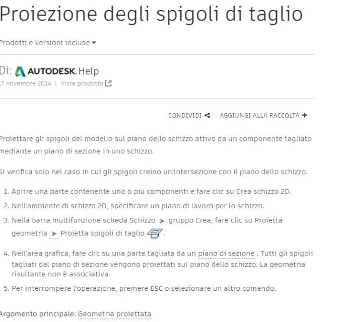

project cutting edges: if you created a plan/scratch, with a click on "project cutting edges" it made me project all the intersection edges of the solid with the plan.
I don't know what you mean.
when you ask for the equivalent of a command of another software you may attach an image or video so that you can also understand who this other software does not know it
graphic cut did not place normal life, but did a solid section on the sketch plane. I'm sorry.
project cutting edges: I can't make a video, I don't have the program anymore.

by chance I found the command similar to the project inventor's cutting edges. after I created a plan, I click on curve intersezione, and I click on the faces I want to project. It's a little more laborious than the inventor's operation, but eventually I get the desired result.TAGLIA GRAFICO.webp
