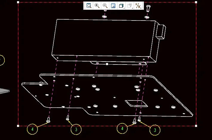

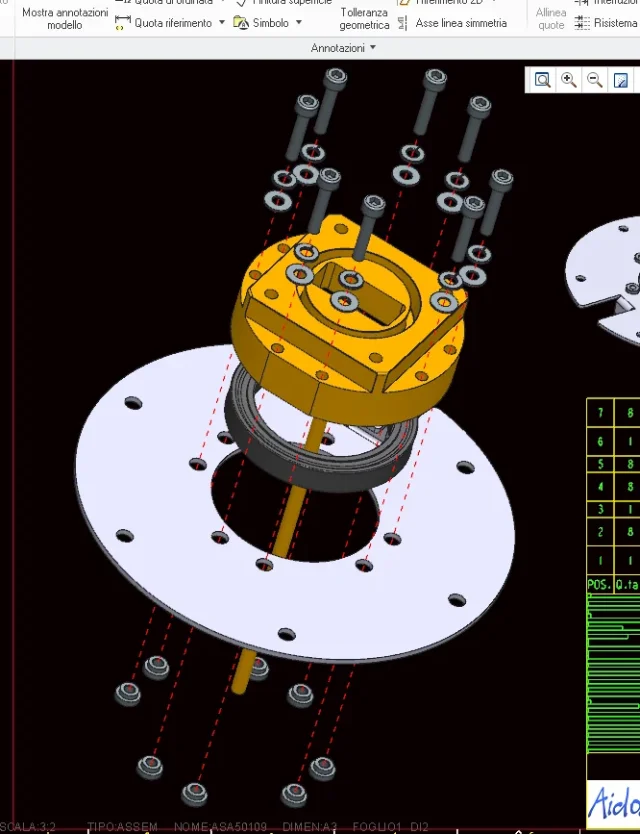

the problem is that the explosion lines are displayed correctly in the views of the 3d but not in those of the design as they lose the "depth" and are always represented in the foreground creating obviously confusion so that they are perfectly useless.
in 3d:2.webpin the table:1.webpBut if instead of choosing the representation "shaded with edges" opto for that "no hidden" then it is ok:3.webptherefore the problem I believe is reduced to understand how to get the shaded representation with edges but without the visualization of hidden lines. and possible?? Where am I wrong?? possible that no one noticed the magagna??

hi, in fact a solution is there but as always with this software it is a question of finding loopholes to bypass its woodness and at this point also its bugs (see that for me it is), loopholes that turn out at the end also perfectly effective but at the price of a huge waste of time.
I put this image to make you understand that you can do it!
1.webpin practice do not use the true lines of explosion (forgetable!!) but the axes of the elements that you can then change as style, color and above all stretch, shorten and add interruptions on the lines where you feel appropriate to give the effect of deepness.
It works.... and cosmetically is entirely equivalent to the use of true explosion lines. ..only that becomes a work of pure "crafts" and not always you have time to think of resorting to this method.
