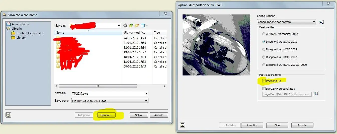

boys 1 problem:
when I do "Save copy with name" and I carry a file in dwg (of any size) I find it automatically exported and zipped. . .
I'm almost certain that time ago did not make me this passage.. He was just carrying out dwg.

when you save by name what?
a .idw file or what else?
in case of the idw, while you are saving, click on options and give it back your rescue parameters.
It seems to me that the pack and go tick must be removed in export, test and let us know!

I don't have a tick, but it does the same to me. Mysteries... I try to put it on and take it off again. Then in case I am going to have a custom config.
Thank you!
I try to put it on and take it off again. . .
That's what you have to do. You'd think I need a shake.
does not do it with all versions of inv. and not on all machines.
mystery, solved with the rescue configuration.
