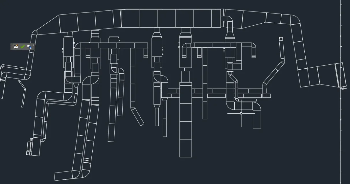

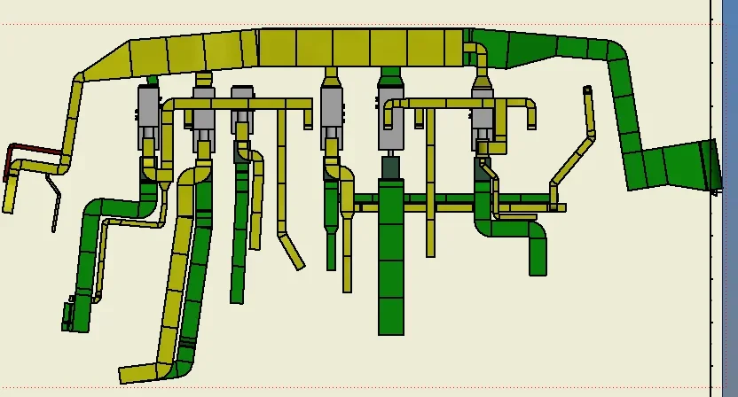

what happened to me and that from inventor.idw I want to export the file in pdf. launching the macro on the idw model the edges become white...and white are also reported in pdf.
You want to tell me that there are layers in pdf? I'll go check. .
ok I saw that in pdf it creates me levels.. that in theoretical line I could change, but I have the option disabled.. ideas?
