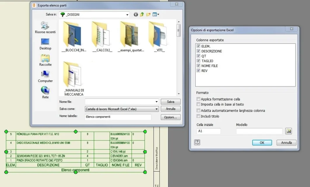

I would have the need to export the distinct components on a corporate "our" template, where do I find the model to be able to process it according to our needs? (choice columns, layout, logo etc.)
No
when you export from the inside of table 2d, selecting with the right mouse button the separate, clicking on export, access through options to what, how and where to export.
find the selection of excel templates
