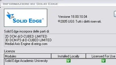

if you go to the window "information on solid edge" what do you see?
great :) I would say that I am riding...better than that could not be:frown:
thank you for the advice, in case I get rid of the situation I will not fail to communicate it. I'm still waiting for other ideas.
r.g.
This is exactly what I see. .

in fact there are limitations on university license. . if you look at the image the 2d cubed- limited and also the 3d cubed - limited
