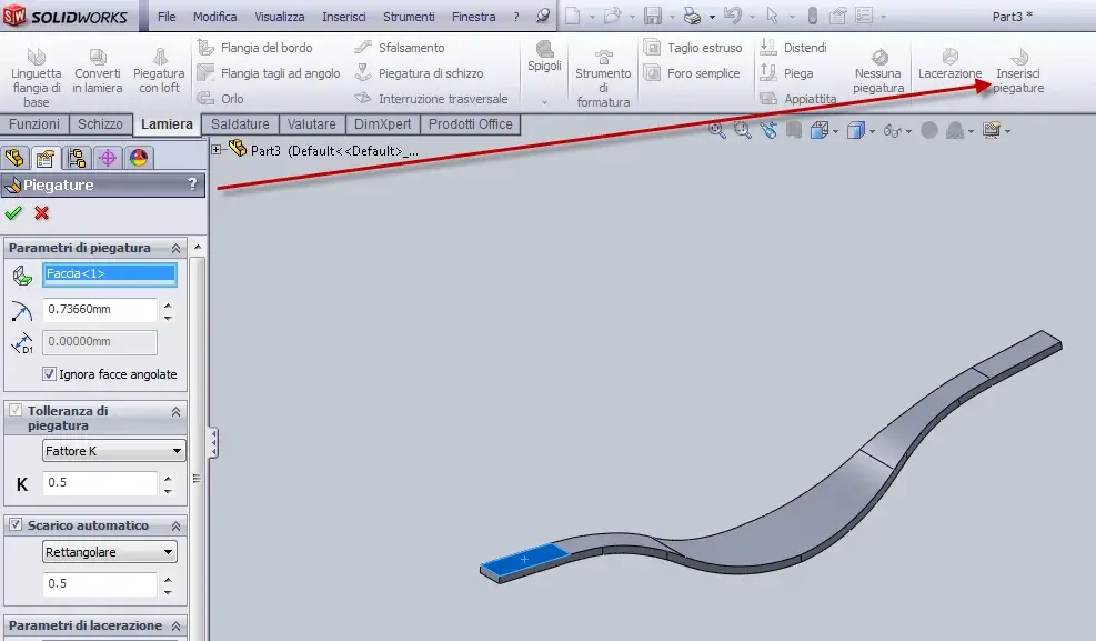

draw the line above the profile (or below), use the basic flange tab command where you will put the thickness you need and the width.Good morning, everyone!

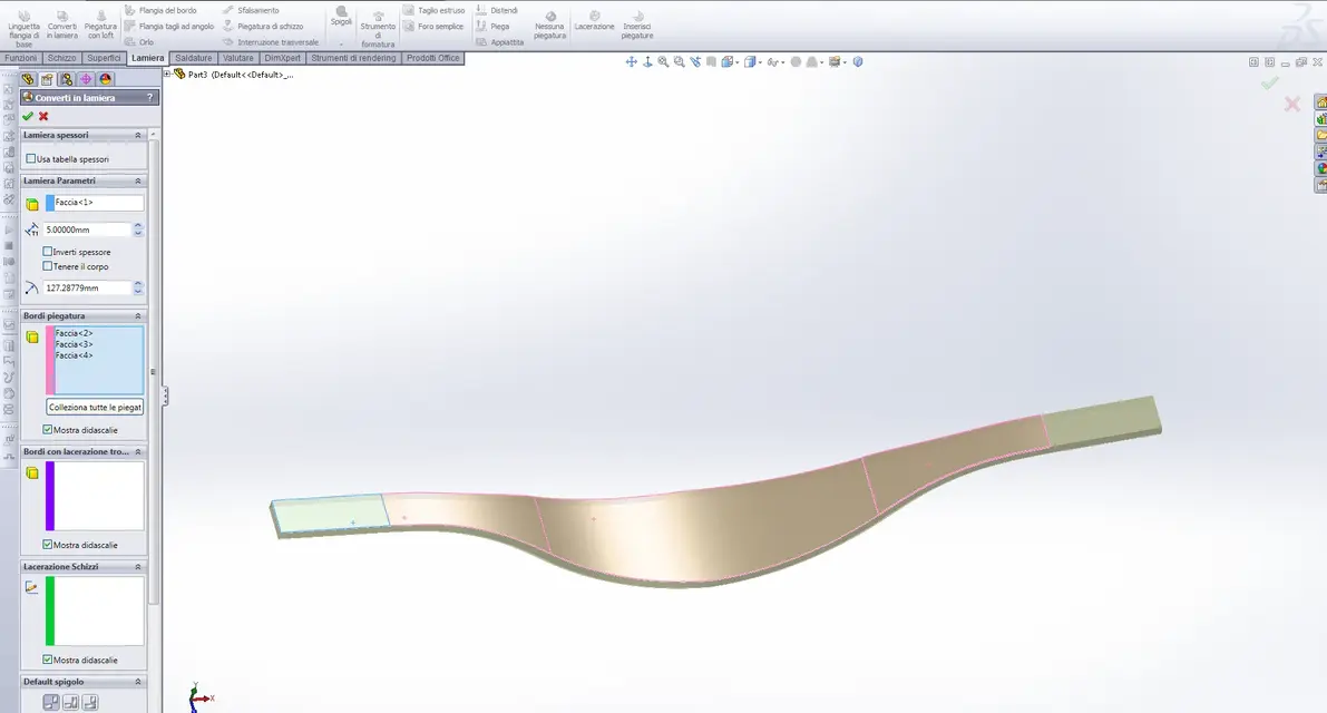

you have two roads, or you do it in solidworks directly as sheet or, you convert it into sheet metal from the body that you open (Annex an image).ok this is the part to relax. I have to cut it out and put it on the mold to give it that curvature. .
