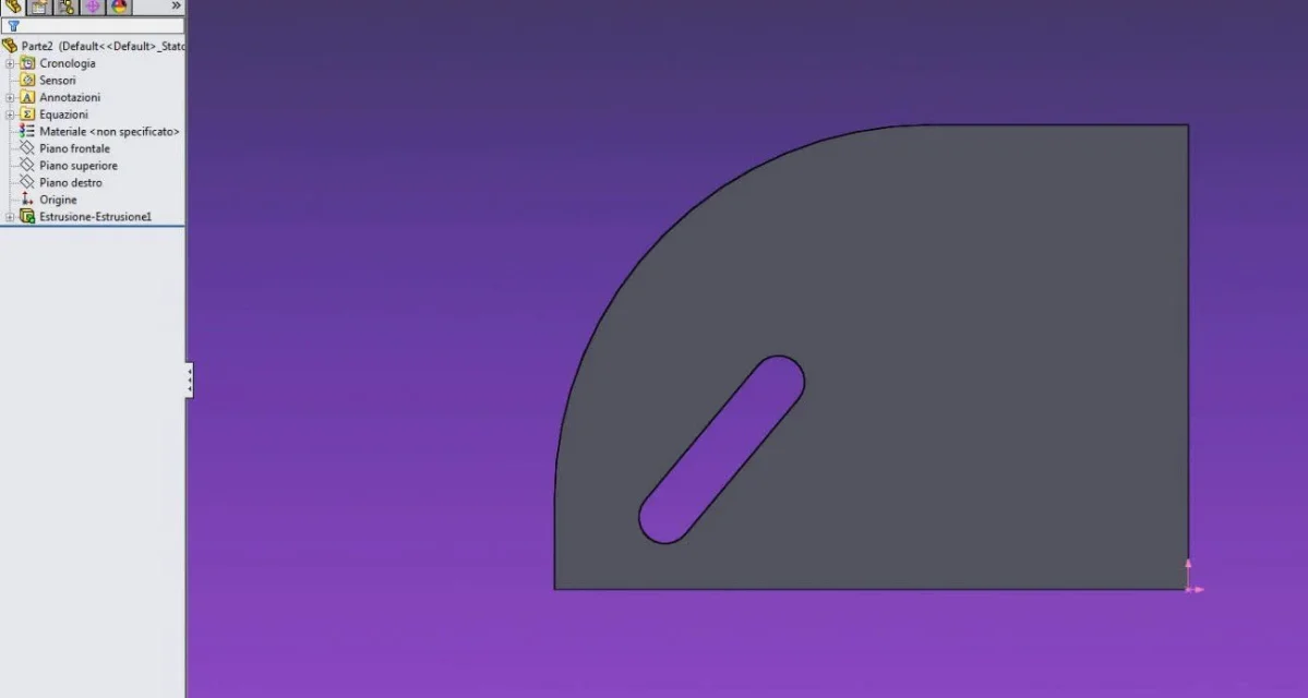

Hello, I have a problem with exporting faces from unconverted solids into sheet metal.
If the face I want to export is the opposite to the main view (x to the right,y to the top) I export it to the wrong side.
I attach image, I do not attach files because it happens with any file, x this example I drew one randomly. Then I choose the opposite hand to how I drew it.
Is there a voice that allows me to choose on which side to export it?
ps: if I convert the solid into sheet metal, then I select the face that I want to export and I export sheet the exported side is the right one, but all sti steps do not make sense. .
Thank you
If you create a sheet you can establish the beautiful side.
if it is a simple extrusion maybe the sketch plan commands
