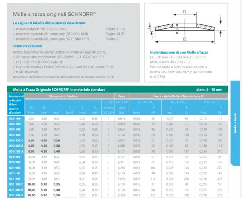

I ask for help for a calculation of a missing value for a study I am doing, I explain better:
I am using a homogenizer (piston pump) for some tests with a customer, who wants to "matemate" the system.
the missing data is that related to the value k of a group of a cup springs (10 + 10) encapsulated with this form: < < < < > > > > > > > > > > > > > > > > > > > > > > > > > > >
the dimensions of the single spring are: d 10 d 5.2 h 0.5, stainless steel material for springs.
Can you please help me?
an early thanks,
Matteo.
