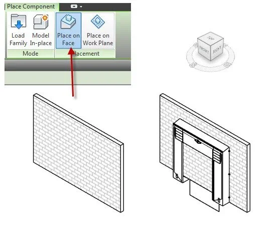

I downloaded a family of a company that produces automous exhaust doors.
Unfortunately this door has been modeled on a horizontal and not vertical level consequently in the project appears lying, lying on the ground.
Is it possible to put it straight?
I train the family
Thank you
this family and "work-plane based". therefore, you can meter it in a 3d view, with "place on face", as in this image:
(also, you can do from a prospective view, but with a "workplane" (a "grid", or a reference plan with a name).

...perfect thanks, I answer you only today because these days I have been absent, the solution has been helpful and I have just remedied.
Thanks again
