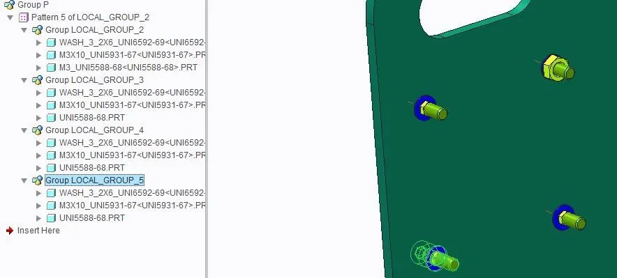

I have a problem with the family table of a pattern concerning washer and nut screw. below I try to explain the problem
each of the three elements mentioned above, named under the name of the reference legislation, is a part file inside which I created the various variants by form and size as from its uni rule. (see figure-a for clarification).
now I have a "father" set consisting of various elements welded together. on one of them I have holes arranged on the top of a polygon created with a pattern feature. on one of the holes I performed the assembly of a screw, a nut and a washer, for each element I chose the father element of each familiy table. after whom I created a group of these three elements and made a pattern for me to recreate the assembly also on the other holes. Finally, for this feature, I created a group to call everything as I wanted (figure-b). Therefore, on the axieme of the on which I performed the assembly of the bolts I recalled in family table the following elements (figura-c):

what happens (fugura-d) is instead that when I go to choose nut screws and bolts on the local_group_1 via the replace command makes me a partial and random update on the other elements in the other local groups created by pattern.
Could someone explain why? I also tried to remake the ex-novo procedure by thinking about a bug at the time of the feature creation.
