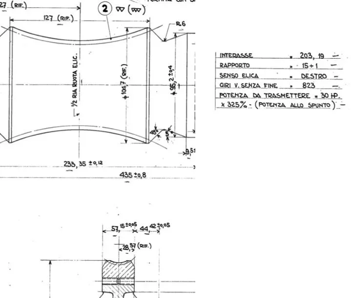

Good morning.
I happen by hand a replacement for a customer: never seen.
Helical gear with globial screw, which caused me to fall from the clouds.
talking to a dentator in my area, he indicated me flender in germany,
That I saw being a bunch of siemens.
I ask you: does anyone know who can produce such gears? ? ?
thanks in advance to all
Googling a little I found This is, in the end he speaks of globular vines, which seems to me to be what you are looking for. most likely with the right settings you can also make a normal toothpick if it has the appropriate equipment
that I know vines do not exist. there are globular screws that are endless screws or made according to the traditional standard with the various types of zc zk cutting etc and then there are the globular screws of precision that are real gears made like the endless traditional screws.
are designable and verifiable elements with kisssoft.
Someone sure she does. if you are talking about the special screws of the rotating boards you have to go to the builders because they are milled with special tools and are not normal.http://www.google.it/search?q=globo...le-heirloom-serp..4.5.700.2mhrbvteyna#mhpiv=3
I imagine there is no way to contact the author of the drawing
It's a very big (and famous) company in northern Italy, which for various reasons I can't say. But I don't even know where they pulled him out. I try to look again for some site of dentators and contact, but I see it hard
Can't you scan a piece of the famous design without the company's name so you can see this famous screw?
and then post it?
if you have no copyright issues of course.
you can try to ask pcm reducers. they also make single gears, endless screws up to module 9 and beyond make it to another toothpick. Try asking them.
Of course, if it is a replacement of an existing manufacturer, just let it build by him. will be a vine of a colombo table and threads or down there. I think you can fix it by going to the manufacturer or one competition.
