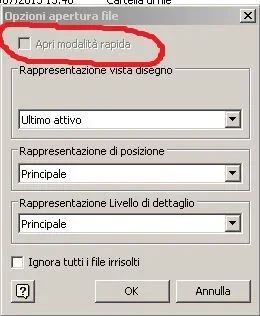

by browsing the news of 2014, with huge joy I found one that is what from the title to this thread.
I read the help, I go into application->axieme options and imposed what there is to set, I try to open a very large file, but in the opening window the incriminated voice unfortunately remains in scigetto :mad:.

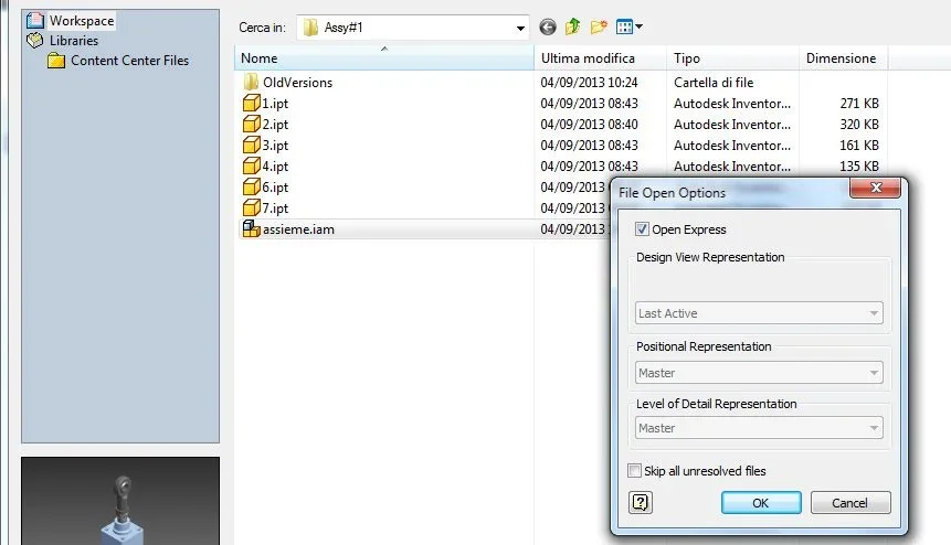

The axieme must be saved, after making the changes you made in the application's options.
if even after saving it or you had already saved it you had to have the same problem test this reset procedure:
close all files.
application optionsdislattered express mode
Applications
open your assembly? save it.
application optionsEnableexpress mode
Applications
open your set?options
at this point should be available.
I tried but it doesn't even go like this. I even lowered to 10 (instead of 500 as default) the number of unique files minimum because this mode is available.
It has to work.
scans the migration of files. (not working with files generated with previous releases)
even if the axieme is great, if you have a way to post it or send it in pm I set it correctly.
down to 100 is influential. serves for automatic opening in express mode without having to switch from options during opening
ok file migrati
You're right I misunderstood the sense, so it's absurd to work even with one part.
I can also send it to you, but what's to set in the files? not enough flag in "application options"?

Yes, but confirm that it doesn't work in your case.
so it would be to be understood manually as never, if without the axieme it is hard.
p.s. nice function, by the way, the express mode
Nothing to do, not even with the files you sent me. then the problem is in the program/installation.
