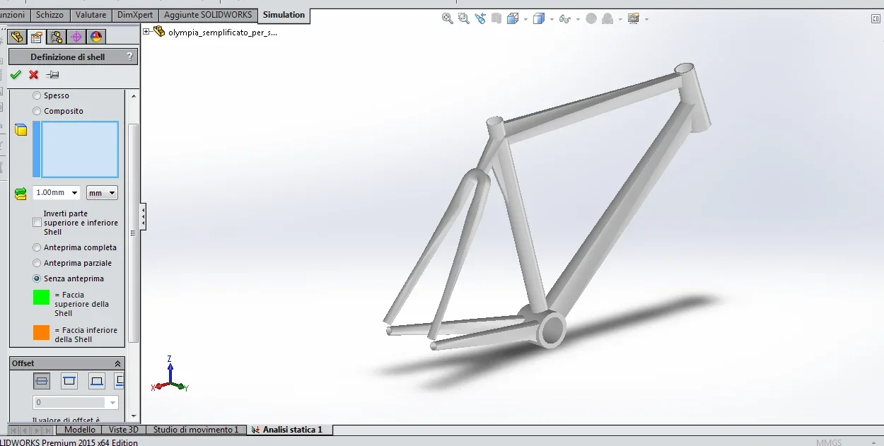

I am a student of ing.mechanics and for a fem project for a university course I decided to do a static and dynamic analysis (simplified) of my olympiaiq monocoque racing frame (I am also a cycling enthusiast).
I have reproduced the frame in solidedge, trying to respect the most various geometries. for fem analysis I would like to use solidworks 2012.
I have already "tested" the frame considering it in aluminum 7075 only to verify the correctness of the geometry and therefore the possibility to create mesh and subsequently stresses, movements etc.

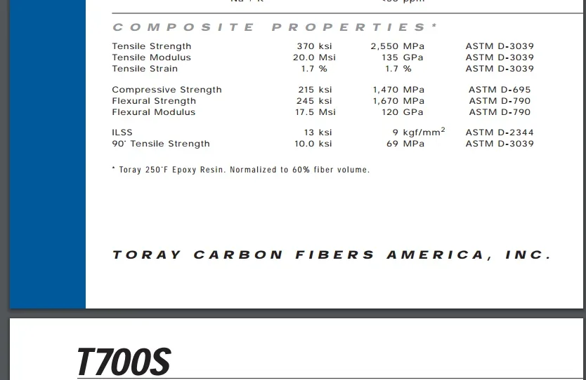

Verified geometry now I would like to remake the simulations considering as a basic material a composite (torayca t700s). I know that this type of simulation is very different and more complicated, to simplify and not to use shell models I could only consider in my custom material (orthotropic material) the values of the mechanical characteristics I found for the composite(torayca t700s)?
Thanks
attach frame image and material data sheet.
