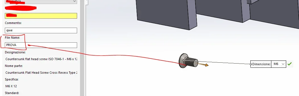

from the toolbox if I use a standard part,when the parts amount together allows me to have the file names taken from the configuration name that I can edit in the table
if instead in the toolbox I load a custom part. .this is not allowed and saves files with file name+ configuration
You know if there's a way to solve this?
Thank you very much
image of a standard toolbox component1648381051975.webp instead in the components loaded by the user only proposes the configuration name1648381207143.webpand the part calls it so "file_name configuration"1648381272032.webpin my case part3_000 (part3 is the name of the file saved in the library)
Does anyone know if it is possible to make him fish only the configuration name or any other custom field?
Thank you very much

Hello simone
Unfortunately not that, the ninth file of the parts uploaded by the user not and manageable, if you know how you do you can explain it to make
