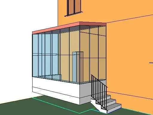

hello to all kind gentlemen, after several attempts I decided to request your help, I have already searched on the forum information to solve my problem but I would need something more detailed, I tell you.
I have a 60 cm high wall, after the 60 cm there is a window that extends in length for 2.5 ml, my problem is to make a door on this mixed wall/glass ......what can help me? ? ?
I also attach an image
the door should logically come where the stairs are located

You need to use a continuous façade system.
you have to change the lower wall so that the wall corresponding to the size of the door is removed.
then insert the continuous facade (with its panels) and in the box (panel) corresponding to the door replace with a door (glass).
for the continuous facade and the door insert, see:http://www.cad3d.it/forum1/showthread.php?t=20295
