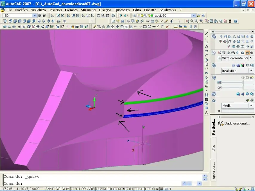

Now I have come to the solid, I practically have to make a radius but that is variable.
practically as you see in the solid, which I posted here, I made two blue and green fittings(r0.5) that turn around the base of the central tree.
only that now as you always see in the solid, I must reconnect, always with a radius of 0.5, the two external sides of those wings, so my new radius of 0.5 must run along the whole side.
only that it gives me error if I include the tilted part that goes to die on the bevel of the central tree.
Can there be any solution?
p.s.: place both model and image, in the image I place the points where the bevel r 0,5

looking at it quickly, if you apply the same radius even to the upside, it does it correctly, otherwise I don't know.
you could try to shape the radius apart, subdividing the solid but I see it hard...
Lattu excuse, to make those yellow fittings, you can tell me the sequence of the edges you selected and with what value.
Hello. I read your help message and thought I'd give you my contribution. I ask that I do not take the 3d program with which you have done the job; personally use catia v5. with catia the problem you have encountered solves by setting the bevel com. indicating the edges you want to remain active in your case: what runs along the vertical fin and that on the upper terminal part of the cone trunk. if the program you are using allows you the game is done. Hi, stefano.
for the fittings you do not have to give a precise sequence, the important thing that they are contiguous and that a valid geometry can be obtained.
set value 0.5 (like others)
