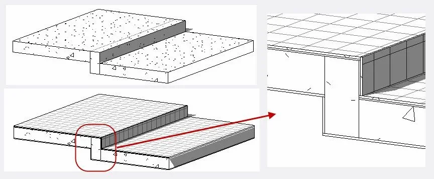

the model can be done as it is built. the beam, the structural ceiling, the finishes, etc... coatings can be made with thin elements.

thank you for the answer!! !
Your solution is what I was thinking, I ask you only what you mean by subtle elements... type a wall constituted only by plaster and one only by the coating of the mirror of the step? ?
and that you know in the element "structural/architectural structure" does not exist the possibility to automatically manage this configuration of the loft (that is to 2 different quotas with step)? ?
max max
exact
No, it's not possible. possibly using the secondary elements but comes a half-rain.. .
exactly.
No, you need to make two floors. One in the level, and the other with an "offset".
