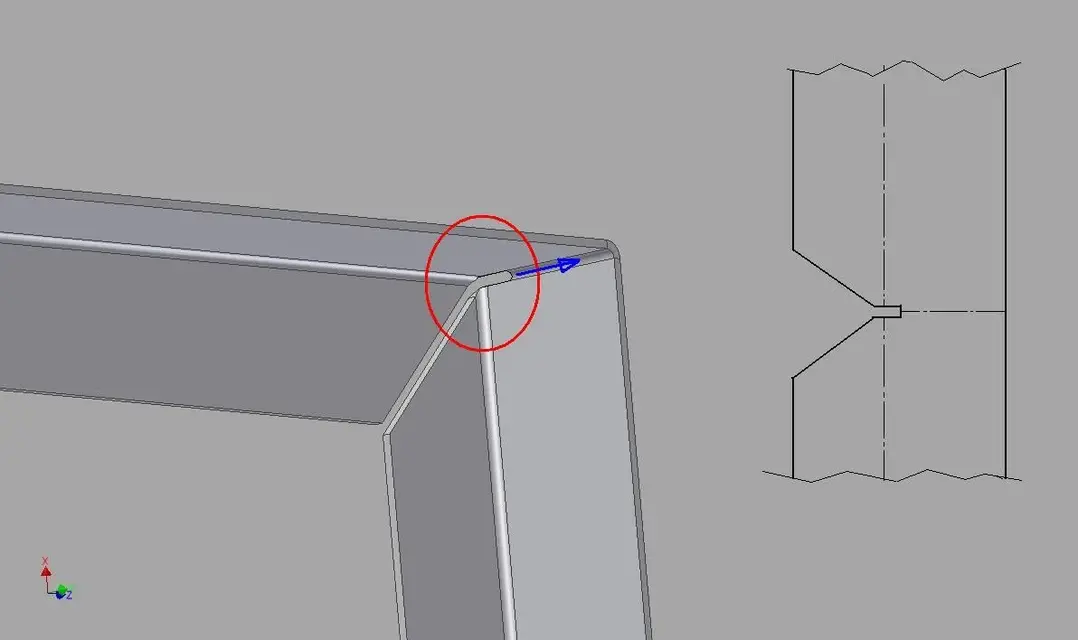

it seems to me that in the end it is worth asking how to give a distance between the corners and a minimum discharge possible and however appropriate to the folds.
I don't see where the problem is, seen that with inventor you can easily set without fears that then doesn't develop.
In fact, you can set these parameters even in the template, or change the fold after making it (see image).
I use a discharge of 0.1 mm for sheets up to 5-6 mm thick,
and no one complained, no bending, no welder, no inventor.
However I agree with sampom, the folder and the welder are those who do real work and it is good to listen to them.
Let us remember that however they folded and welded before the cad....
