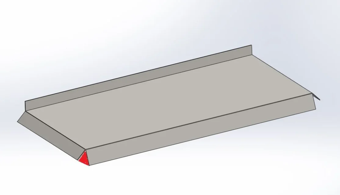

Good morning to all, I asked if there is a function to close the corner between the two flanges of the edge (red triangle in the image) once arrived at this point of the detail or already in the development a closing triangle and then bend it?
thanks for the collaboration.
sw professional 2017
but would it represent a welding?
test with closed edge.
you can hardly do it if the flanges have different length; How would you relax him?
no massive, it does not represent a welding, I have to approach as much as possible with the two folded stems to close the crack (instead of welding a sheet triangle to understand). I tried with closed edge, even bringing to equal measure the flanges, but it gives me error.
in any case in the online guide, under the voice "spigolo closed", there is an image similar to mine, so I don't understand where the problem is.
because you set in the bending parameters the bending angle to 0. so when the edges of the flange do not run the drain and sends everything to aches.
right button on sheet set the fold radius to 1 (=thick) and you will see that you will be able to insert the closed edge
