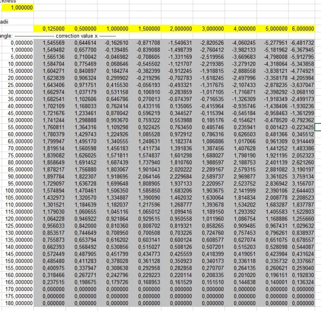

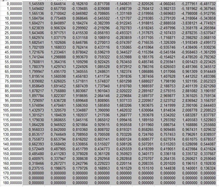

in the design folder data\bend tables find the file banda table (mm).xls
open it and impose the thickness value1619697474819.webpformulas, update the table.
at this point selections to make the copy-paste1619697534333.webpin inventor create a new table-based explanation rule1619697609216.webppositioning the mouse on the crossroads-table, paste1619697750951.webp...prove ....
