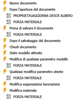

I found this that writes iproperties and at the moment I write it with the triggers in the model:
dim odoc as partdocument = thisdoc.document
iproperties.value("custom", "material") = odoc.activematerial.displayname
but it's not the solution... only a plaster
what I miss is the copy of this in the table iproperties.
just to say how it works right now. . .
open table from this model and with triggers I update the table at "return"1647011959757.webp(maybe there are too many but it is very light as "macro")
