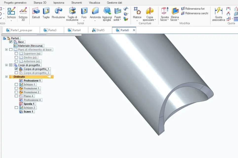

Hello everyone, I have to head a tube of ø30 with a arc r.15 to be then coupled to another tube ø30. the problem is that the header r15 is made with a laser tube that rotates the piece and moves along the linear axis creating a non-perpendicular semicircle and therefore when I go to lean on the second tube I have an unexpected contact I ask: is it possible to simulate this processing so that you can determine the excavation to do in the second tube to have a precise coupling on the outer edge?
