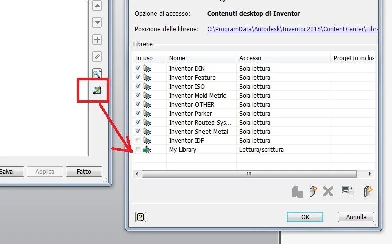

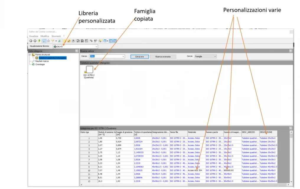

Hello
I created in a custom profile library folder that are identical to the existing ones but I added properties and changed description. for this I made a copy of the single family of profiles and I added the columns/changed the words, which I wanted. Now I get the problem that when I open the "insert frame" dialog box I don't know how to make my custom books appear, because I get the usual rules. Thank you.
you have to go to your current project and tell him to upload the new library
