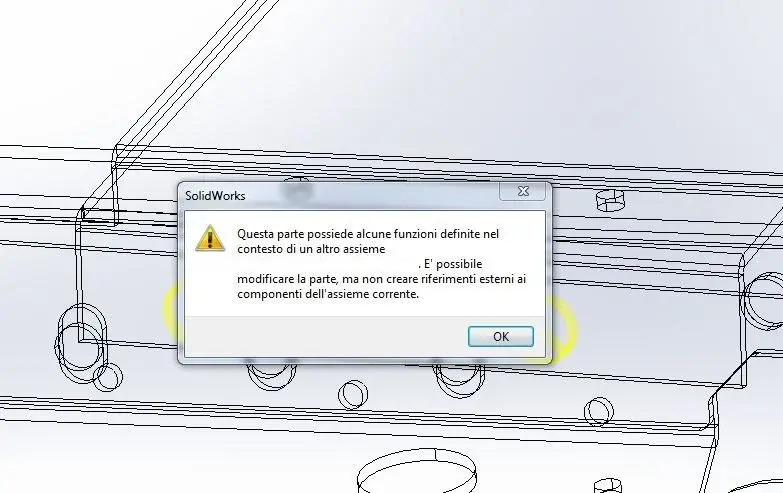

How do I avoid this problem?
Thank you
Obviously that component has functions with constraints or quotas made on another set.
do dx button on the part you are editing and checking (elect external references)

we say that I modeled the part in the axieme x, then I saved by name the axieme(we hypothesize name y) then I open y (x closes automatically obviously) I opened the part in object and I also saved it by name.
Here, after this tyra should not create references related to the axieme y and not + on that x? correct me if I'm wrong
Did you save the copy?
If I know you'd better duplicate it via pack & go if you don't have a pdm.
so you solve the problems of references.
no I did not save as a copy, because I avoided manually replacing the component(for laziness)..I had to make a pack&go..dici that is the best solution?
