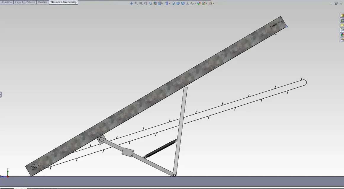

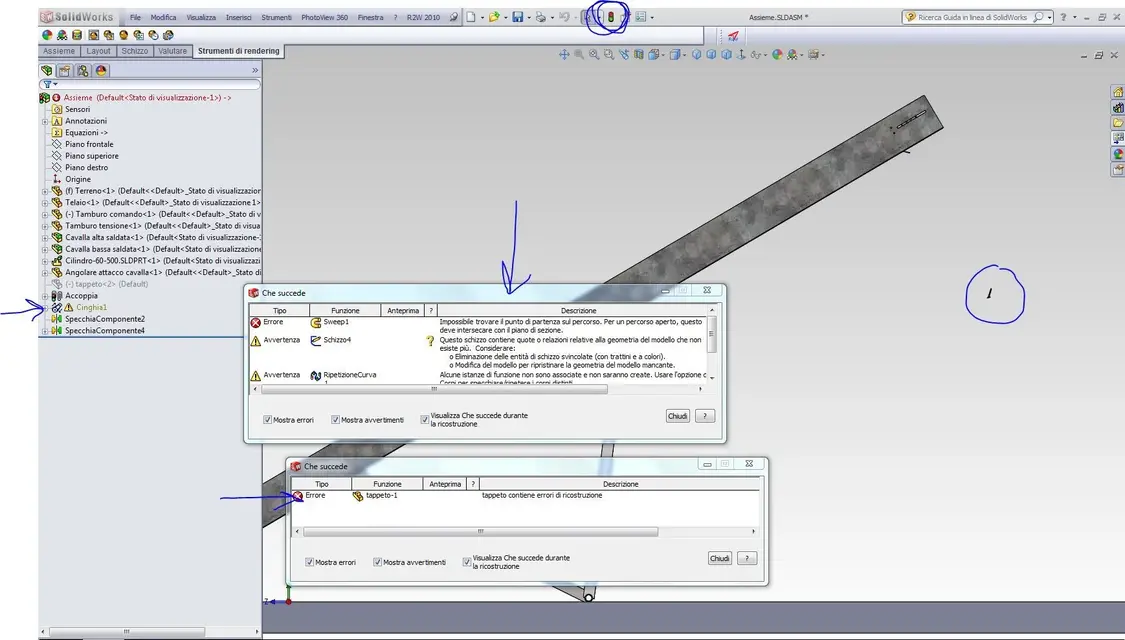

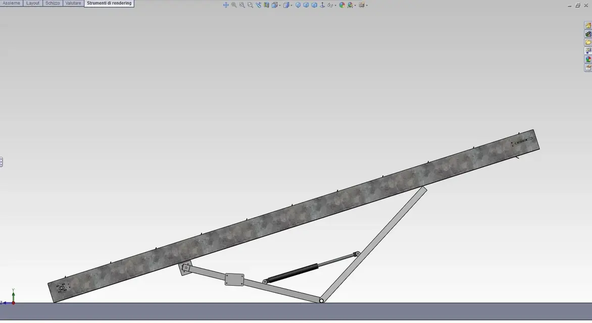

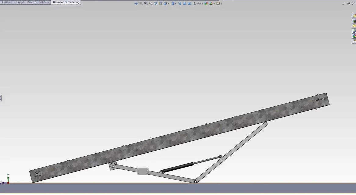

I have a belt wrapping on 2 reels,
the rollers are fixed to a frame that rises and lowers,
It happens to me that, if starting from the bottom, I lift the frame of a little and aggiorno, the strap follows me and does not give errors, if I rise too much I get a mistake... :confused:
I don't understand the reason for the mistake... and you?

The error is due to the sweep function. I have always done the tapes as a subtle extrusion. I changed the tape, but the palette is missing, but the problem is solved. with the sweep there was the sketch of the tape width that obviously did not remain normal for some reason.

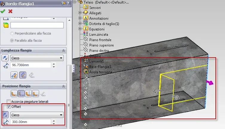

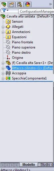

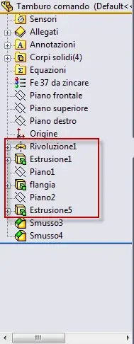

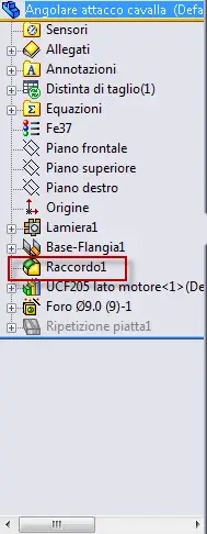

I wanted to add suggestions:
Reggio 1) why did you create an exhaust and then another to bend when you could do it with a single function?
reggio 2) why did you not create a sketch of layout and extruded several times?
Why use the revolution when you could use the subtle extrusion?
save time and the piece is faster in rebuilding.
Reggio 3) why did you do a set when you could put it in the welded?
reggio 4) do not use classical modeling functions in the sheet environment, use the commands of the sheet where they are present and possible.

... dealing with the same part and remaining unchanged the distance of the rollers, I don't understand the reason for the error.... and you?
the error is due to the swee...
It also works with the sweep. only that the tape profile sketch you have to do it on a "dedicated" plane and not on the right system. the plan must pass through a point of the path and be normal to it, so that it is always "legated" and that it always follows.
Also the skewer sketch you have to do it with a little "cognition", that is bound to the surface of the carpet.
1) because you created an exhaust and then another...
Reggio 2a) because in the drum you do not have a sketch of layout.. .
2b) why the revolution when you could use the subtle extrusion?
Reggio 3) because you made a set... ?
4) do not use classical modeling functions in the sheet environment. . .
1)It is true, in another post we had seen it, in this case I had already "resolved" so and I did not put + my hands...
2a)I don't understand what you meant to ask me? ?
2b)I made it easier for you, in reality it is not cylindrical. . .
3) also this question I do not understand (consider cmq that all the aid was simplified before posting it)
4) I was trying to do as you suggest but without "exasperation", if it gives advantages now I will try to follow the straight, thank you ;p
I have seen, thank you, I will continue cmq with belt/chain only to have more easily the measurement of development.
