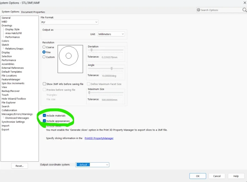

What is appearance?
1726143337159.webpSorry I have the English version I don't know the translation they used...cmq when you save by name for every type of file there are the options try to change to play a bit sooner or later find the one suitable for you... I leave so and it doesn't bother me.
