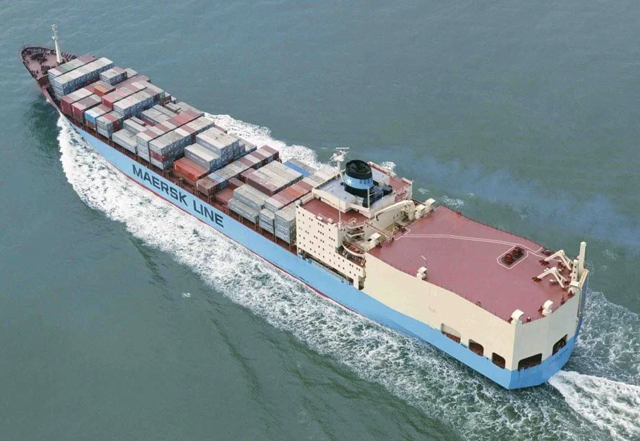

observing more carefully the photos found on the web it is known that in reality the tower was not built to bare wire but was backward of a few meters compared to it.
How many meters?
was this possible?
The black wildcard has been modified. the stern was not originally so to "beam".
as I said in a previous post, the poppiera superstructure was added later. the escalation over the original stern has perhaps made the same "mount" on the dock hitting the tower still more internal?

Let's start talking about the facts.
the black wildcard originally was a portacontainers called axel maersk.
built at the shipyards blohm & voss ag of amburg in 1976 construction n° 892 launched on 12 December 1975 delivered on 28 May 1976 to the company a/s d/s svendborg& d/s af 1912 a/s (a.p.moller) of copenaghen- danimarca. steel hull, flat keel, square aft, bulb, mixed longitudinal transverse structure, 2 bridges, 2 partial bridges, 210.8 m long - 6,939 t.
in 1978 it was stretched to 225.0 m.
in 1984 it was again elongated at the Hiroshima yards at 239,30 m and renamed adrian maersk, turned into ro-ro and equipped for container transport. new length f.t. meters 239,26, length between pp meters 224.00, free edge mm 2637, dive meters 12,218, gross flow 30.461.
remotorized with a new diesel engine b&w type 8l90gbe at two times, 8 cylinders arranged in line, diameter mm 900 stroke mm 2180, plungers with cross head of the power of 23.389 kw at 97 turns/munto and speed reduced to 21 knots.
in 1994 it was converted into a conro ship and used by the military command for maritime transport as a ship of support during the Gulf War. the sturdy structure of the bridge of the garage, the remarkable height and, the large ramp could easily allow the load and transport of heavy armoured vehicles including tanks m1a1. is equipped with two cranes 40 t.
later renamed "sp5 eric g. gibson" owned and operated by the lines maersk, it was used with other ships to transport support materials including lubricants, medical supplies, spare parts and chemical defense equipment. on 26 June 2006 it was sold together with the Maersk arizona to Mexican ignazio and cspa of genova for about 8 million dollars. is currently used in the links between Italy, the Red Sea and the Arabian Gulf.

I attach some pictures of the black wild when it was still the axel maersk and in the already black wild basin.
