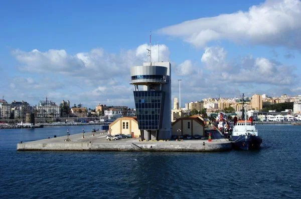

even if I have seen a port only from google, it seems to me that even this realization allows a minimum defense to the tower.

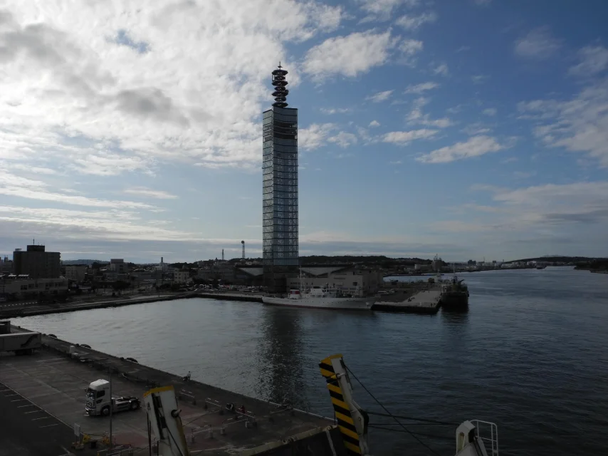

This does not seem evil to me, always ignorantly and without wanting to be sentient.

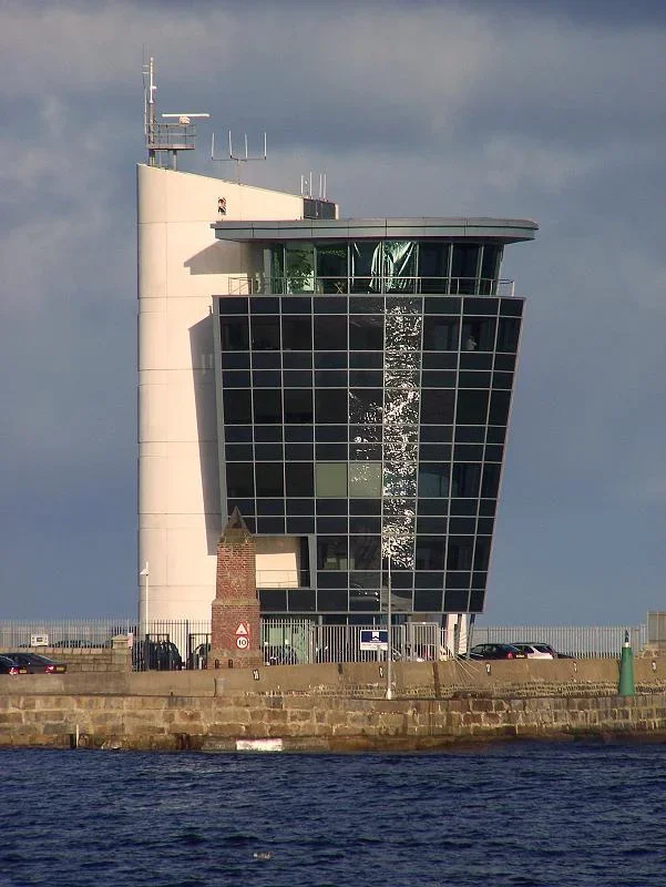

a real pearl of wisdom, but these have space and money in vagonate.

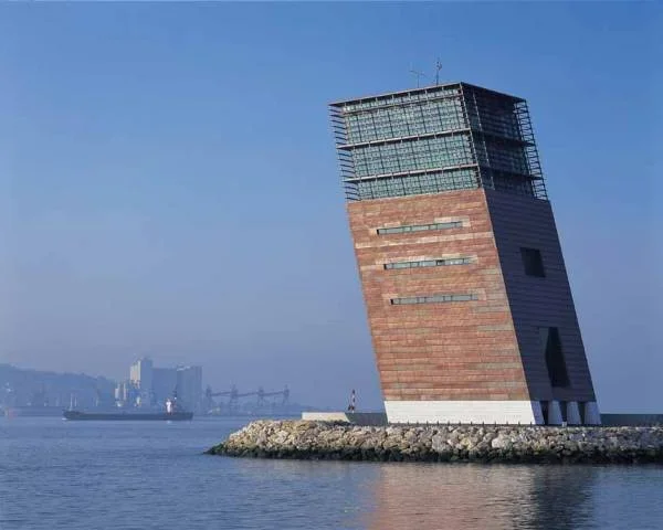

This, always ignorantly, I could consider it unprotected, but perhaps it must not oversee an international port and however its little bit of pier has it, perhaps under the fur of the water will be an artificial cliff that widens the protection, can not be said.
