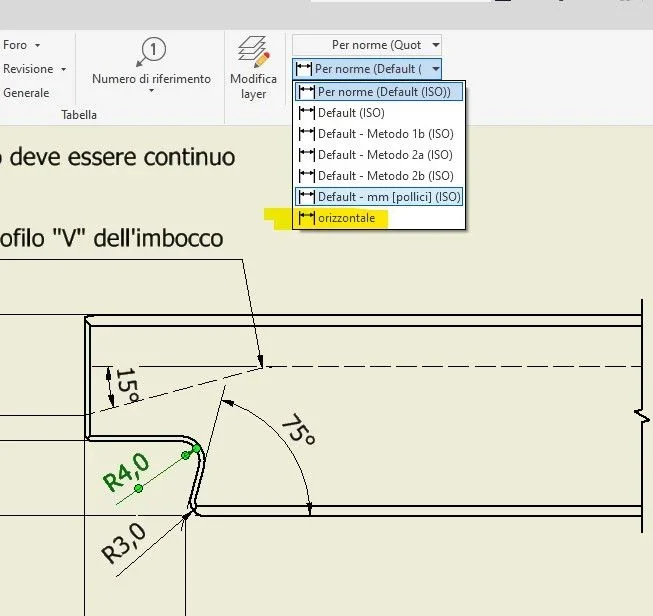

Good morning, everyone.
I apologize in advance, but I can't find the exact terms to indicate my problem, I hope to make me understand.
necessary to "explain" the quotas. in the sense that I want the line of the quota to go longitudinal, but then I need it to become parallel to the horizontal axis (or vertical, depends what I am listing).
try to attach an image that can make you understand better.

you have to change the height style (or create a new one) in the style editor.

I tried to follow your screenshot, but odds do not change

Okay, I got it.
your screenshot is wrong.
we must not go into notes and direction, but in text.
igo imagequote.webpThe problem is that now the ray quotas, it does all that.
While I need you to do just what I'm interested in, not all.

edit:
This problem has also been solved.
I have crated a new style of quota and called it horizontal (management-edit styles-key dx on any style of quota- new style)
save and close
select the share you want to change.
select from the drop-down menu in annotation, the horizontal quota format (or what interests us).quote.webpI wrote the procedure, so that if someone else has the same problem, it's a little more detailed.
