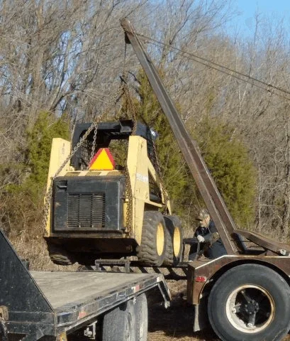

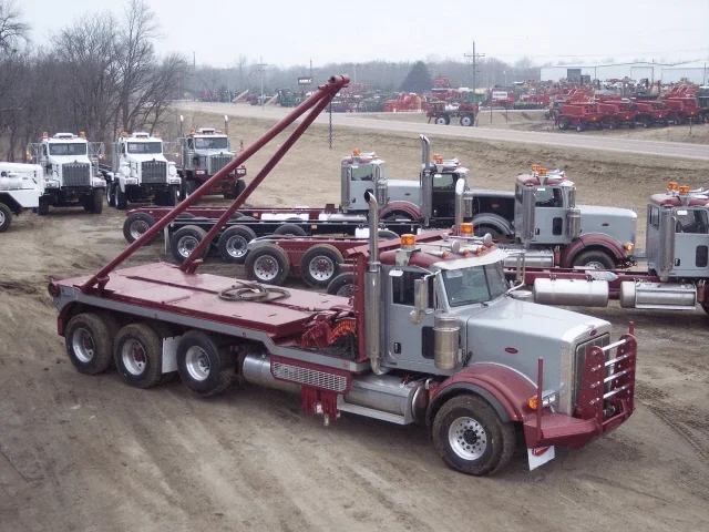

Hello, excuse me the unusual question a little overwhelmed, on the net we have seen that in the US oil industry, they use in the petroleum wells sites of the artigianally trained trucks called gin pole, they would be like mobile paranchis of the goats, of the escalation structures installed on the planes of the trucks that are used as lucky cranes to raise and move heavy loads, who in Italian do not to dimension a similar structure that to what I see is not equipped with stabilizers, as you should do, with a useful flow of 2 tons and a useful height of 3 meters under hook, which method to employ,. Thank you.

hi, in Italy and in Europe you use the en 12999. It is probably not the norm for this type of equipment but you have to lean on something. Start seeing that rule and then you make a pattern. you will need a parachute/argan (en 14492-1 or 2, depending on whether or not they win or hoist). You're gonna have to counter it.
Did you do a search on the American standardization site? Maybe find the standard they are built with.
In my opinion, without stabilizers, you're gonna break your tire and... Good-bye! The stabilizer must be put, it is a question of stability and therefore safety.
then, remember also that it must be approved (vehicle) and will be subject to the periodic verification regime because it falls into all. vii of Legislative Decree 81/08.
In fact, thinking well could become a mobile crane ... even more complex!
in 13000... after 12999!
