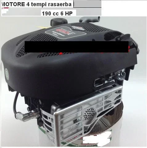

engine: I think one of these, from 150 -200 European 3600 turns 5-6 hp (if not baran)
Motore.webpoutput below or side ,(maybe better for the things I have to add)

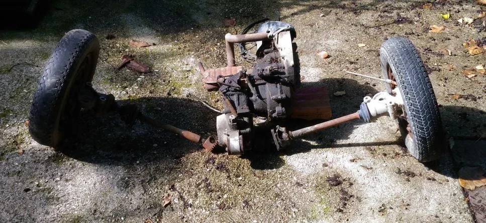

group gearbox differential gearbox and differential ape50 scraped therefore also retromarcia
I don't have the clutch, but I think I'm going to strap it up with galoppino.Ape50.webp (up to 6 - 7 horses I made similar in the motors of the conveyor belts). I have to disassemble and separate the change, make a closing door and fix the pin entering.

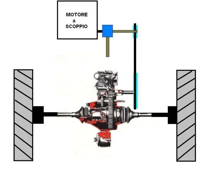

differential, steering etc.
differential + steering wheel for the other two wheels or (as well as interlocked vehicles) without steering. since I have wheels with brake bolts, if brake wheel dx turn left and vice versa.
then disposition completely: width of the middle, as much as the diameter of the rotating blade so the wheels do not beat on tall grass but only on cut grass? square structure with axis in the center (such as electronic robots) so I can reverse a wheel block and rotate in an ideal point in the center? so very handy. But for the balances, slowly everything.
Meanwhile a question: rotating blade radius 40 cm (x example) medium sharp, how many spins/minute could serve? I have no experience in this case.
