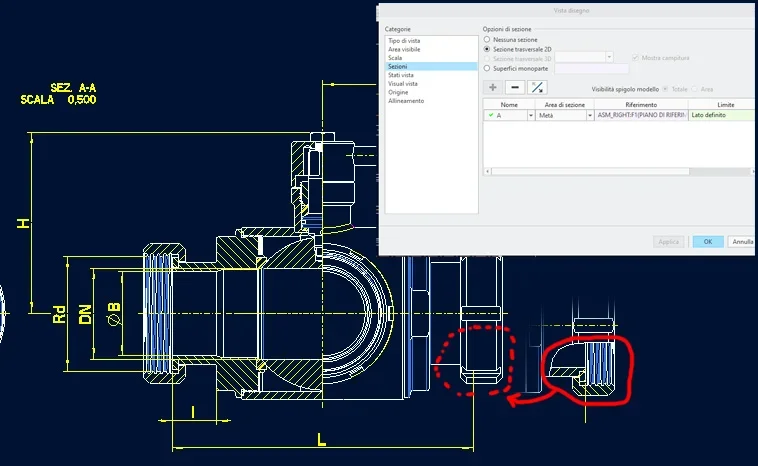

as you see I have a section, indeed half section a-a of a view.
I would like to add in the same view and on the same floor a partial section where I sign them; but despite in the asm I created two sections with different names by leaning on the same floor then on the table does not allow me to create the partial one. Where am I wrong?

If in the asm you have dissected with the correct plans you don't have to have problems in the table. from the photo with that orientation of the piece/assieme takes only section a, so the problem is in section b. the procedure you described is the correct one anyway.
Mah, something I'm sure wrong because she won't let me. if I do the first section "a" whole then let me add the "c" (which is on the same floor)...if I write it. "a" I do "half" there is no more to add any other section. not even creating a little staggered reference plan and creating the sez. "c" on the last one lets me do it; It's absurd!
You know you're right, I've been trying and I can't go neache. I also tried to see some option on model property but it doesn't seem to have found anything, I'm sorry.
on a view with half section you can not add any other section.
you have to create half section with #offset_section
in the table add the offset_section as half section and in addition the partial one.

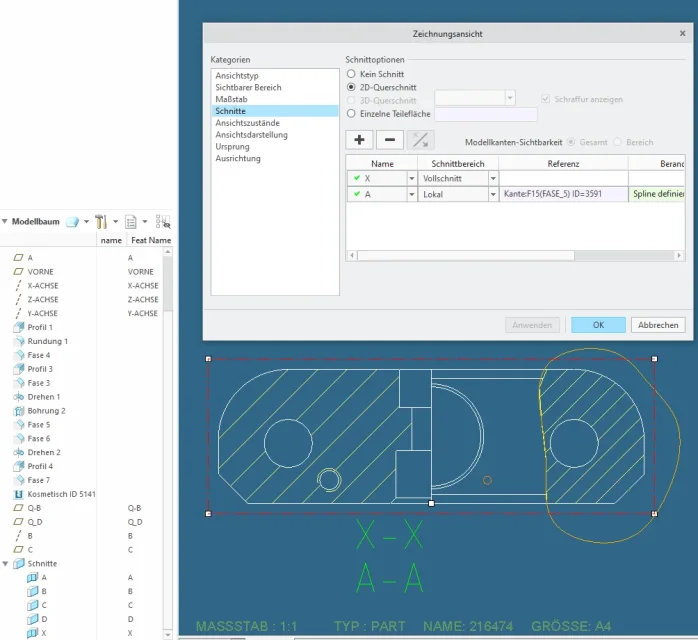

Hey, you mean something like that? I wanted you to see me just where you see it, and with the offset section, I can't do it. . .

No!
half section should be created with #offset_section (x-x) and then a partial section (a-a)

You're mythical, making me two on the same view. You're still funny!
