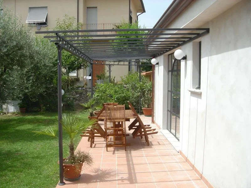

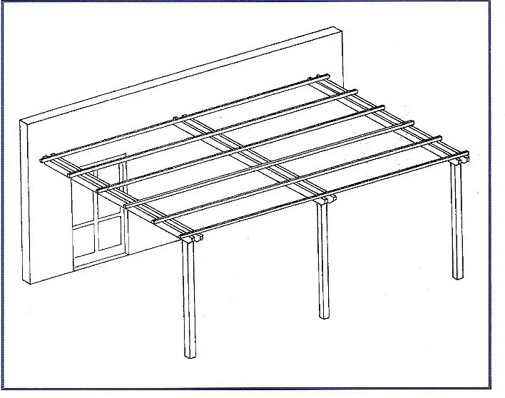

Hello, I don't know if you can help me, however I pose the problem, for a house at the sea we will want to create a boned pergola or a wall resting on one side to the perimeter wall of the house to the other from 2 vertical iron plant to anchor to the ground you could help us to dimensional the various parts and to suggest the proflilati to use? the measures are length m 6 front height m 3,20 wall height 3,60, we will have to realize the pillars of the plant the horizontal cross on which to rest the ground, the flanges to be fixed to the wall and the various elements of the frame on which we will want to apply a transparent material likely polycarbonate,/ pergola what you recommend to do ? thanks to those who want to suggest the right method and the right materials and construction elements, the weather will not
View attachment 38904View attachment 38905
missing data: depth, on what anchors the mounts... if the 6 meters are unique light or if you have intermediate mounts.

steel and aluminum in marine environment do not agree at all ... teflon seals to not put the two materials in contact.
Good morning, I'm a tightener and I've made several covers like that.
if you want a council realize the structure in galvanized iron and possibly hot painted the sections can be enough of 80x40x2 , on the length of 6 m you have to realize a reinforcement (traliccio) .
as advice cover the compact polycarbonate of 4 mm at least.

Hi rf... .
the last thing I would do and to plant a steel structure by the sea
if you look on the web and find the various shell builders (constructors-no-installers) you notice that everyone uses
aluminium threaded couplings and clamping systems in stainless-aluminum mixed material
screws and bolts vary in stainless steel
steel by the sea needs continuous maintenance must be painted every year
and if everything goes well you always have somewhere quaalche "break of rust"
also if I enter another prob.
building a solid structure in iron fixed to the floor by means of plinths and the cement construction with beams etc.
it may be considered as a volumetric increase in the case
so much joke
an articulated light structure with plastic joints is considered a sun or water tent
Maybe you just have to give a communication of beginning work
