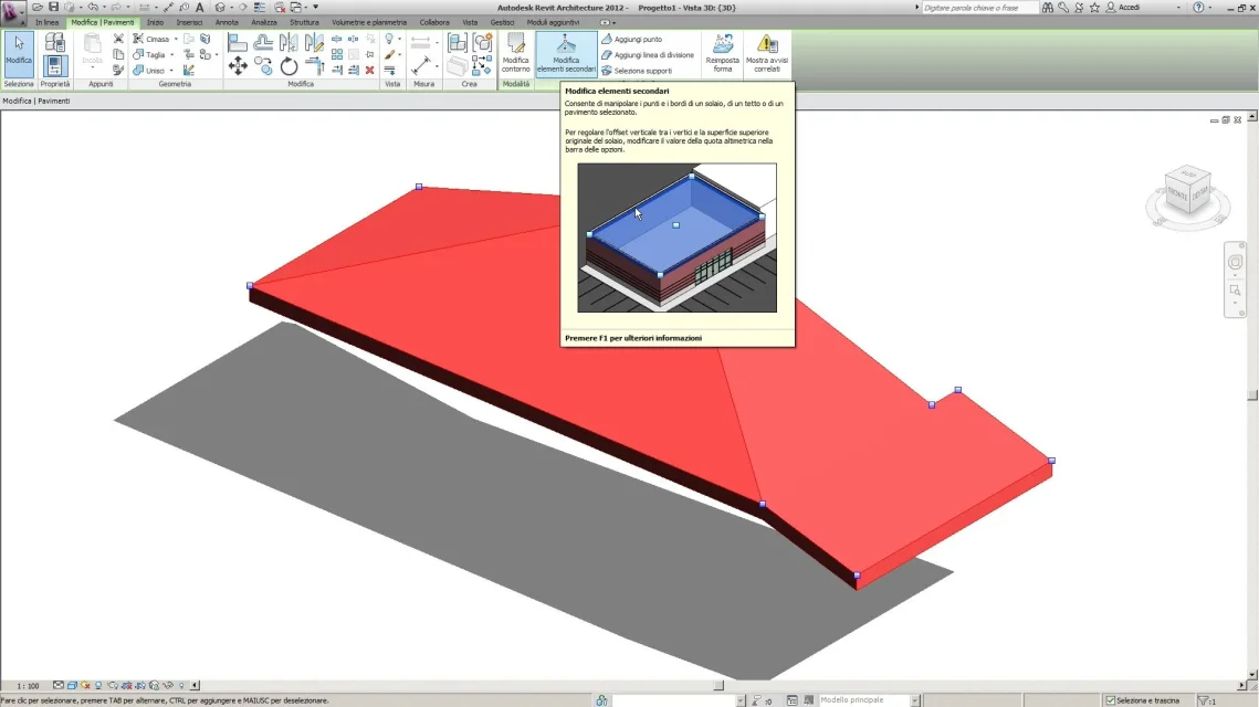

it will be a little difficult that the red line (red line) can stand on the same altitude, geometrically only the 437 long sx eaves and that under 1130 long will be on the same altitude, the long dx part 500 will be lower than 210xpendence roof.
also because the bisectors do not divide the angles to 45° and you will have bonfires with different slopes
you can do it with distinct bonfires, or make a unique roof using "surface roof" first building a solid reference on which to place it, 3rd solution uses the floor command and then with "change secondary elements" from the odds you want to at the points of the ground that will appear to you as green squares
