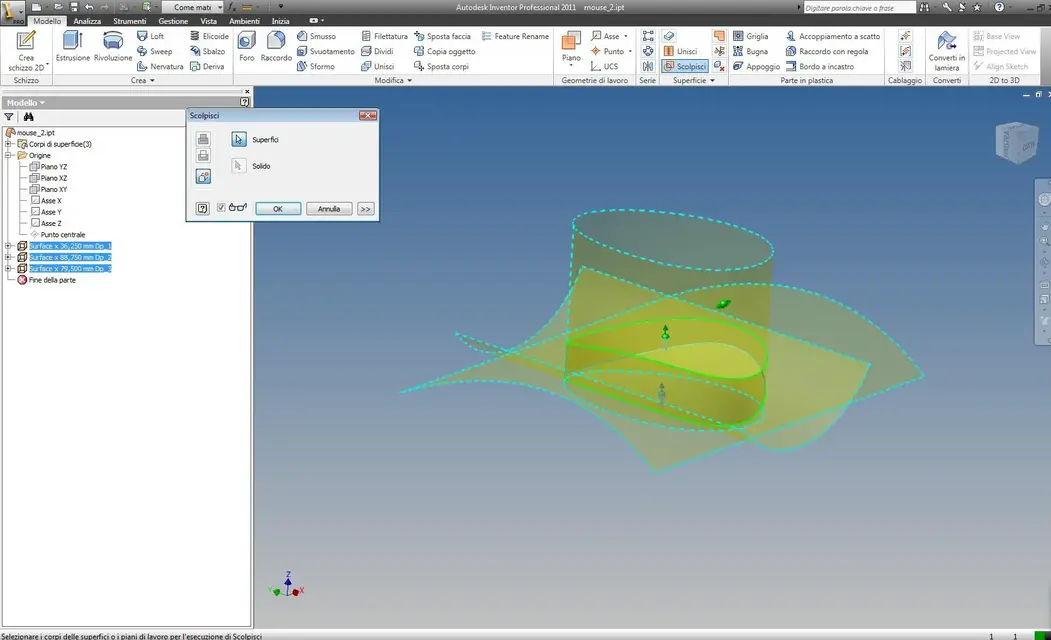

I ask you: when and how would you use the sculpt command in the modeling phase? Thank you!
if different surfaces, but also sup and faces, define a closed volume the sculpt transforms it into solid. like all commands, however, can also serve to subtract material or intersect.
just select the surfaces and if they locate a closed volume sheet it turns into solid
