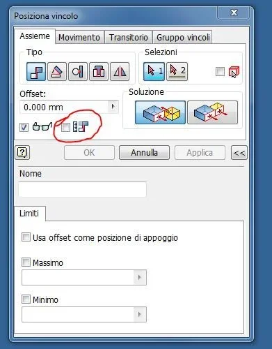

It might be that you've popped the "estimated offset" if it is so unchecked.
Stima offset.webpedit.
the hypothesis of stefanobruno is more sensible.. .
tendon management --> remove tick to " postpone update "
Yes thank you was that I did not "update" and clicking on the yellow lightning updates to me; I can not remove the tick from postpone update because I see only the command under "upon mass"; I apologize but I am a neophyte and also looking in the online guide I have some difficulties.
