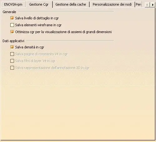

check in "options\product structure\cgr management" that the "save lineic elements in cgr" option is not selected. Similarly check the option "save 3d annotation representations in cgr".
erase all the cache and reload the axieme.
This way only solid geometry should be displayed.
wireframe geometry will only appear through the design mode.
greetings
max max
Thank you very much:
I set up as in the image
